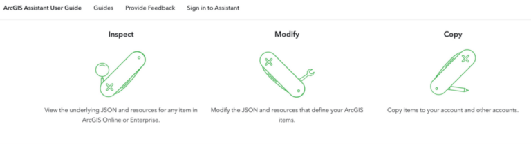

A potential pitfall of this approach is if you include a web map in your native app that wasn’t built by yourself or your organisation, the web map may disappear one day.
However, you can make a copy of that web map in your own account using a community-driven project from Esri Professional Services, ArcGIS Assistant (in Beta phase). It’s a “sandbox” type environment and can be used to copy maps and apps, work with web map items JSON and more.

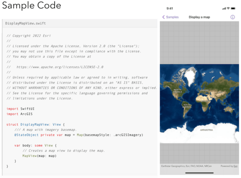

#3: Let’s code! Copy useful code snippets.
Back to comfort zone now: coding! One of my favourite productivity workflows when building an app with the Native SDKs is to check the ArcGIS Developers website for sample code, code snippets by topic, tutorials and API references.
My specific trick here is browsing the tutorials to find starter app code specific to my project, or including that code within an existing project. The tutorials walk step by step through the code implementation, or there is a handy download solution if you want to jump straight into coding in your IDE. For example, for writing the iOS native application for this blog, I used the Display a Web Map tutorial to get started.
Using the new ArcGIS Maps SDK for Swift as an example, check out the sample code and star and/or clone the Swift samples GitHub repo to keep up to date with the latest features. You can also download the iOS sample viewer to get an instant insight into what’s possible when building with ArcGIS developer technologies.

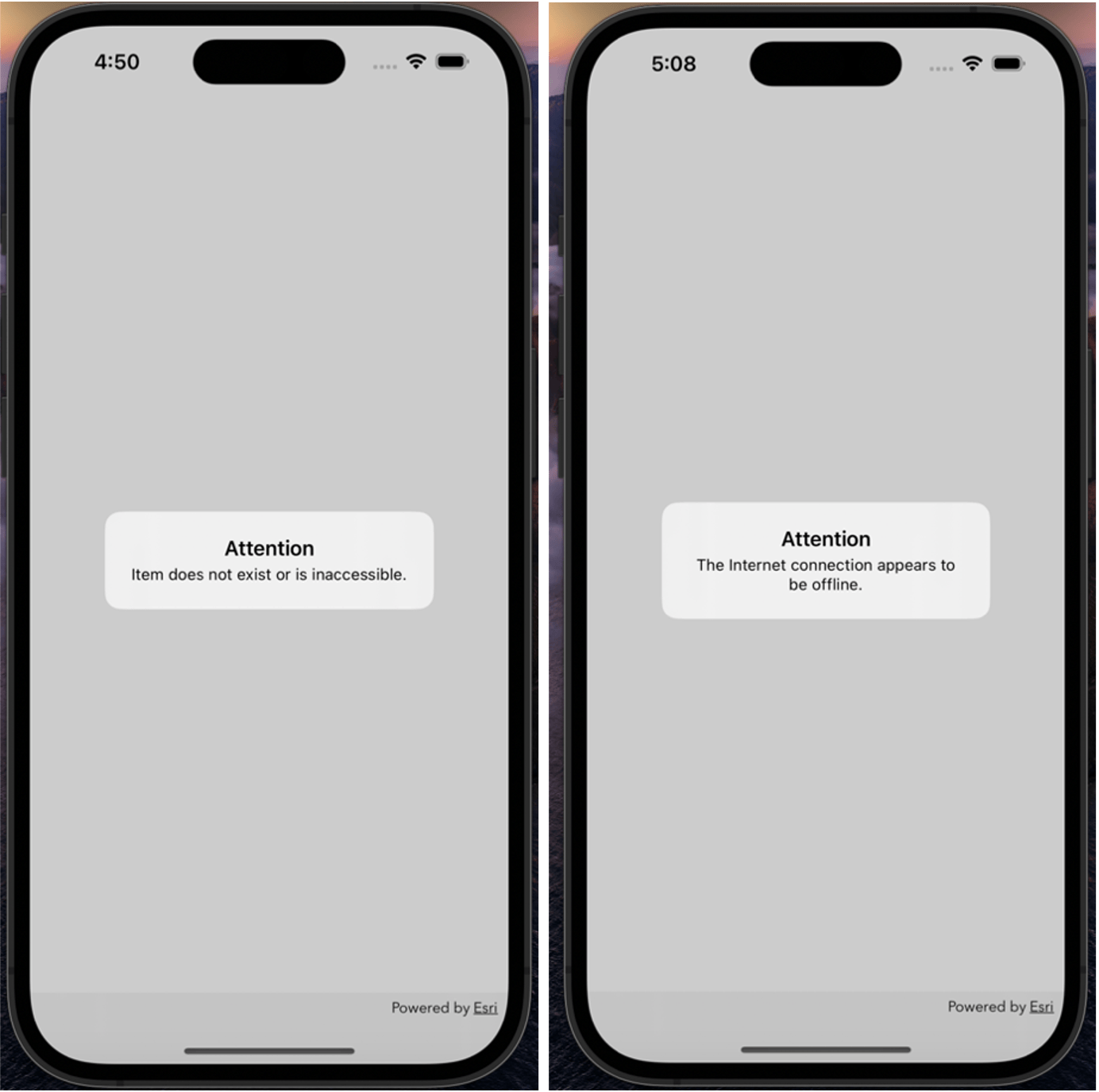

#4: Loading issues? Turn errors to your advantage.
Resources from your web map, such as layers or basemaps, rely on remote services to initialize their state. In the Native SDKs, the loadable design pattern loads metadata for these resources asynchronously, whilst also allowing a mechanism to properly handle and recover from network outages or service interruptions. If your web map doesn’t load for whatever reason, your whole application could fail or not work as expected.
As a developer you can remain in control if this situation occurs by using the loadable pattern in your app. For example, in the following code snippet for an iOS application, I’ve set up an app with the ArcGIS Runtime SDK for iOS that displays a web map. I’ve added code (highlighted) that implements the loadable design pattern, where once the map has loaded, it will check for load errors.
If there is an error, it will display an alert containing the description of the load error. The load error description contains information as to why there was a problem loading the layer to help you or your user troubleshoot.

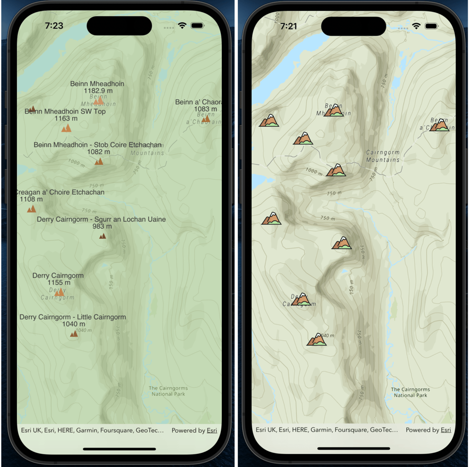

#5: Own your app! Customise it with renderers.
My final trick continues the theme of keeping in control of your app when developing native applications using web maps.
The symbology used in the web map might originally display ok on a mobile screen. But what happens if the symbology is tweaked later down the line, without you knowing about it, and suddenly the symbols look too cluttered, or it just looks plain wrong on your mobile application?
You can guard against this by overriding the web map’s renderer before the layer has loaded: the overridden value will take precedence over the value specified in the layer’s metadata.
Taking the web map of the Scottish Munros I shared earlier, when it displays on an iPhone application, the symbology didn’t look right for mobile, with the labels displayed being too cluttered for a small screen. Using the code above, I set a custom renderer that overrides the web map’s metadata symbology.
It uses a custom .png, removes the polygon fill of the national parks layer, and also disables labels to make it more appropriate visually for mobile. As the developer for this application, I can remain in control of the look and feel of the app whilst maintaining the data from the web map.
