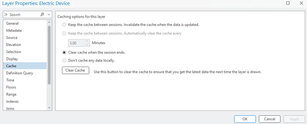

There are two types of caching: layer caching (feature layers) and feature caching (web feature layers or feature services). By default, all feature layers can be cached using caching options. Feature layer source data can be from a database, an enterprise geodatabase, or local layers. In this case, the cache is used to display extents you’ve previously visited.
Cache
Additionally, both layer and feature caching are used to reduce the number of queries sent to the data source, which is useful when trying to explore data in the map. In an enterprise environment, caching occurs by default, which reduces the number of data access requests. When multiple users edit data in the same area, they may require access to changes more frequently. In this case, if users need immediate access to updates, do not use caching. Also, when using any form of caching, data edits made by other people are not visible in your ArcGIS Pro session, so you must set caching options.

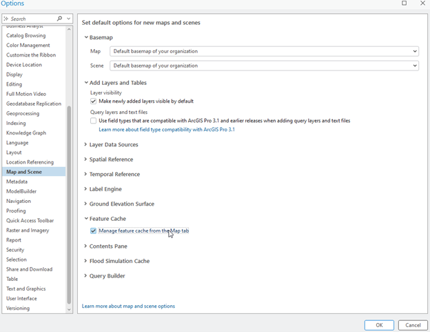

Feature cache controls are on the Map tab in the Feature Cache group. If you do not see the Feature Cache group on the ribbon, enable it in the project options under Map and Scene.
Add feature cache controls to ribbon
Once it is enabled, you can manage the access controls from the ribbon on the Map tab.
