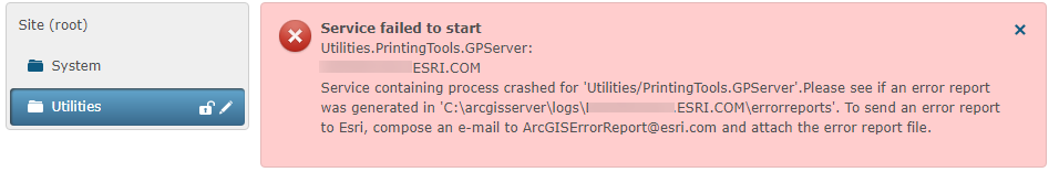

Screenshot of error message for geoprocessing crash
A sample screenshot of the error message displayed when the geoprocessing service crash occurs.
This bug prevents users from running geoprocessing jobs, publishing new services, or using the default print service in ArcGIS Server. The problem is isolated to machines running Windows Server 2008 R2 and Windows 7 only, and only occurs once the above updates are installed.
