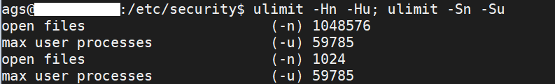

All good to go, right? So I revert back to my ags user to verify, but end up with this:
What happened? One reason why the change did not occur is because you are not in a new non-root user session. If you simply ran the exit command from the root user back to the non-root account, no new session is formed. In order to see the change, you must do one of two things:
  1. Exit the terminal session and start a new one.
  2. Run command su ags and verify the file handles and processes limits.
Whichever method you choose should lead you to see the following:
