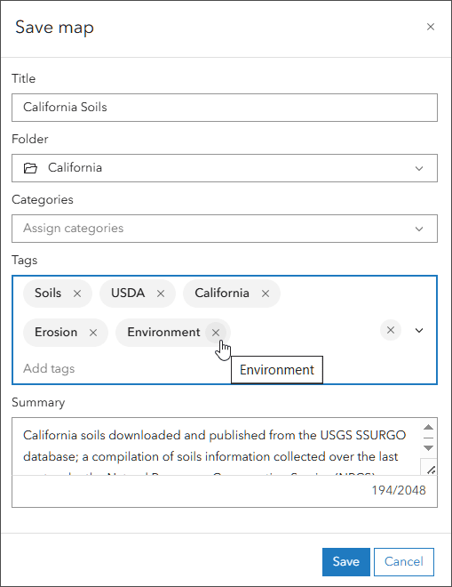

You can add or edit tags when you add any item, or save a map, app, or layer. You will be prompted to enter tags, and can choose from previously used tags, or can enter a new tag. Begin typing to find an existing tag, or type to create a new one. Click the X following the tag to remove it.
Save Map dialog with tags

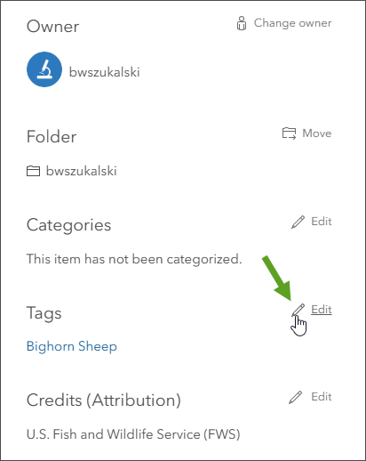

You can also add or edit tags from the Overview tab in the item pages.
Overview tab on item pages
Tags are found down along the right side of the page. Click Edit to add or delete tags.
Edit tags

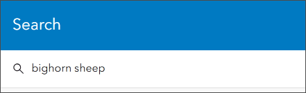

Each item in ArcGIS Online has a title, summary, description, and other information. When you enter a string in Search, all of these fields are scanned for a match, including the tags. Close matches are also returned via stemming, which finds derivative and closely related words.
For example, searching for “snow removal” will find anything that matches from all the available item information. Results are organized by the default of relevance, or your choice of title, owner, rating, views, and date.
Search using a string

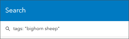

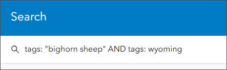

If you want to search for a specific tag, use the keyword tags: in your search string as shown below. For tags using multiple words include surrounding quotes.
Search using tags

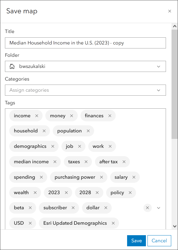

When you save a map authored by someone else, existing tags will come along. Shown below are the numerous tags that accompany the Median Household Income map from the ArcGIS Living Atlas.
Tags in the Median Household Income map

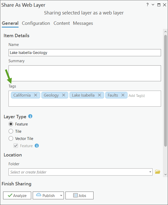

Tags when publishing from ArcGIS Pro
Using ArcGIS Pro, you can publish maps or layers directly to your ArcGIS organization.
Share tab in ArcGIS Pro
When you publish (share) maps or layers using ArcGIS Pro, tags are also required. When you share a web map or web layer, the share dialog will present the required input box for tags.
ArcGIS Pro publish map dialog
See Share a web map and Introduction to sharing web layers for more information.

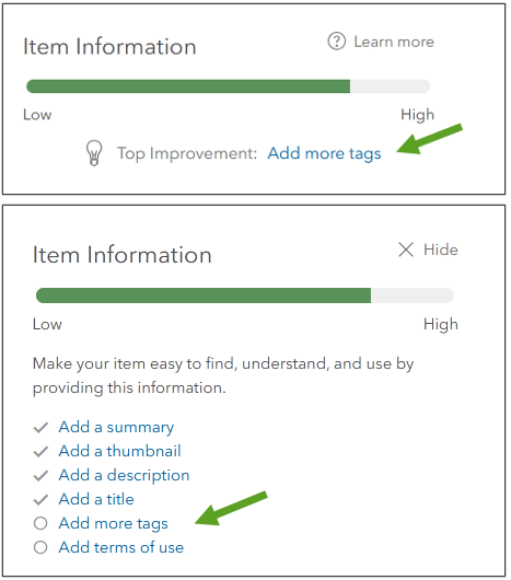

Tags and Item Information
On the overview tab for your items, you will find Item Information. It’s a relative scale from Low to High which helps you create better item pages, and identifies areas of improvement.
Tags play a factor in your rating, and below the top improvement for the item is to add more tags.
Item Information tag suggestion
Scroll down along the right to add and edit the item tags.
Edit tags
One tag is required, but add more using your own judgment and following your own tag guidelines. The tags you specify should correspond to keywords you think people will use to search for your item. See Item details for more information.

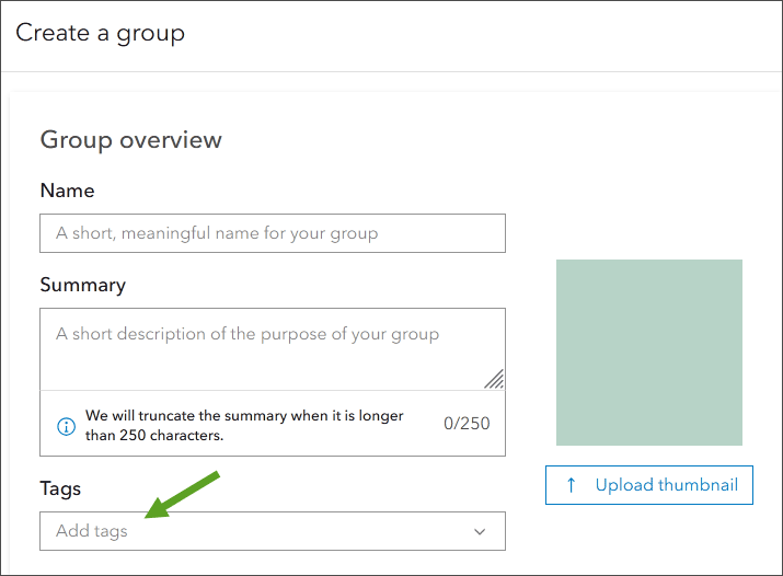

Tags and groups
group is a collection of items, often related to a specific area, subject, or project. You can create one as a way to organize and share items. Groups also require a tag, which must be entered when a group is created.
Create group tag input
Group tags can also be edited from the group Overview tab.
Overview tab on group page
See Create groups for more information.
