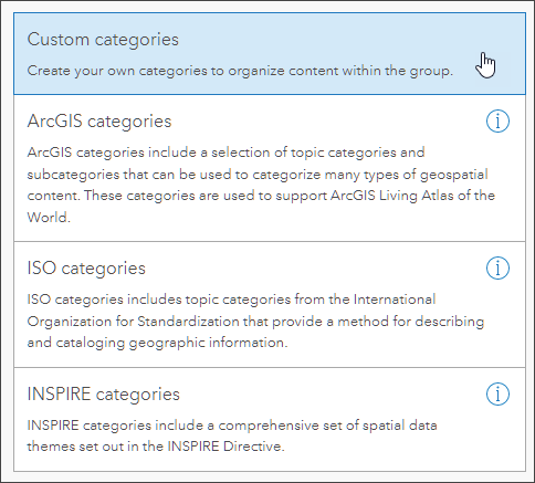

Step 2 — Choose a category templates. Available templates are:
For this blog article, Custom categories is used.

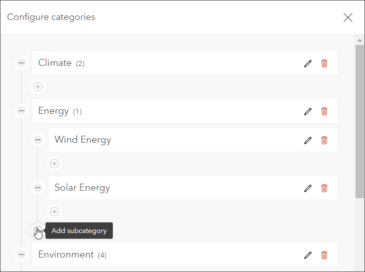

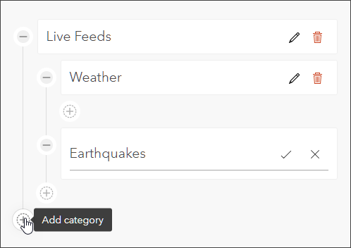

Step 3 — Begin by entering the first category in the input box and click the checkbox when finished. Add new categories and subcategories by clicking the (+) button, or edit and delete existing categories as desired. You can drag and drop categories to arrange them. Once established, categories can be edited at any time.
Step 4 — Click Finish setup in the lower right when done.

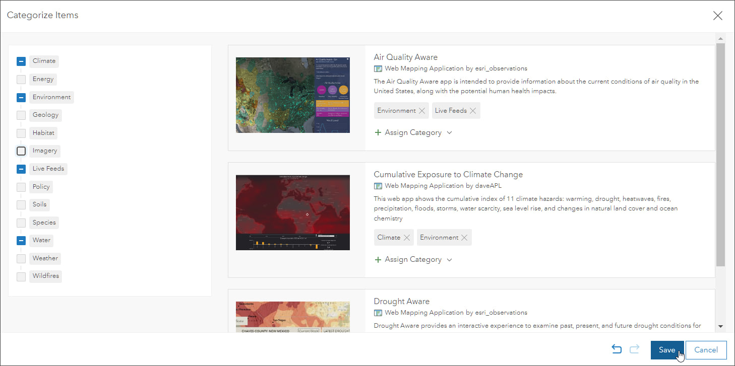

Select one or more items and choose Categorize, which can be found in the More drop-down list.
Categorize item
Step 6 — Choose one or more categories for the item, click Save when finished. Repeat for other items you want to categorize.

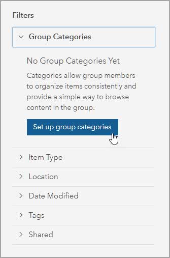

Look for Group categories in the Filters section along the left side of the group Content page.
Configure group categories
Click Set up group categories then follow Steps 2 through Step 6 in the Configure organization categories section above. Once items have been assigned categories, the group category filter can be used to view specific content.

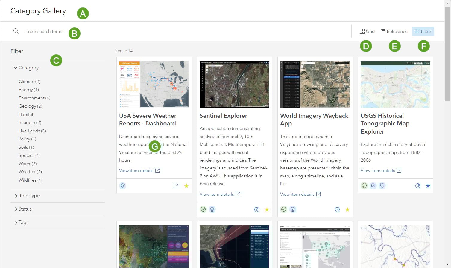

Use the Gallery Instant App template
Gallery is a responsive, group-based Instant App that allows you to display all of the items from a group in a searchable and filterable grid, table, or list. You can view items using a variety of criteria, including group or organization categories, type, date, status, and more.
Viewers can open the items directly from the configurable display card. The unique capability of Gallery is that it enables filtering on organization or group categories and can be used to enable group category filtering by users when the app is public.

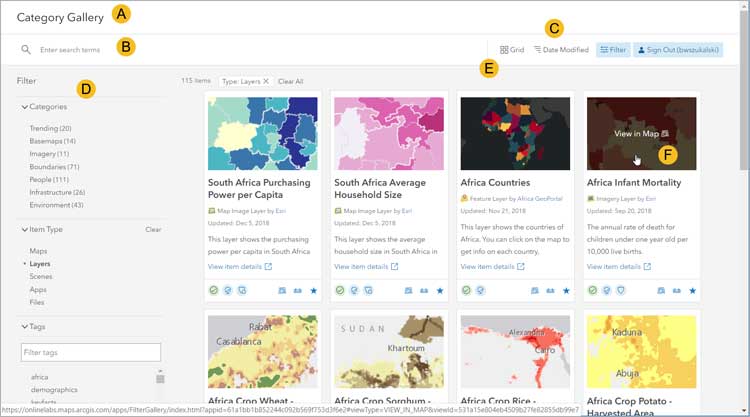

Gallery setting
Gallery includes a number of easy-to-configure settings, including the following:
A — Title.
B — Configurable filters, including by category, type, tags, status, and more.
C — Grid or list display for group contents.
D — Sort order.
E — Hide or show filters.
F — Configurable item card.
G — Share app with current filters.
Gallery Instant App

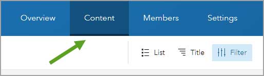

Step 3 — Add categories to the group. Open the group’s Content tab, then click Set up group categories.

Step 4 — Choose one of the existing category templates, or choose Custom categories to start from scratch. For more information, see Content categories.

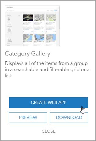

Step 9 — Choose Gallery from the Instant Apps home page.
Choose Gallery

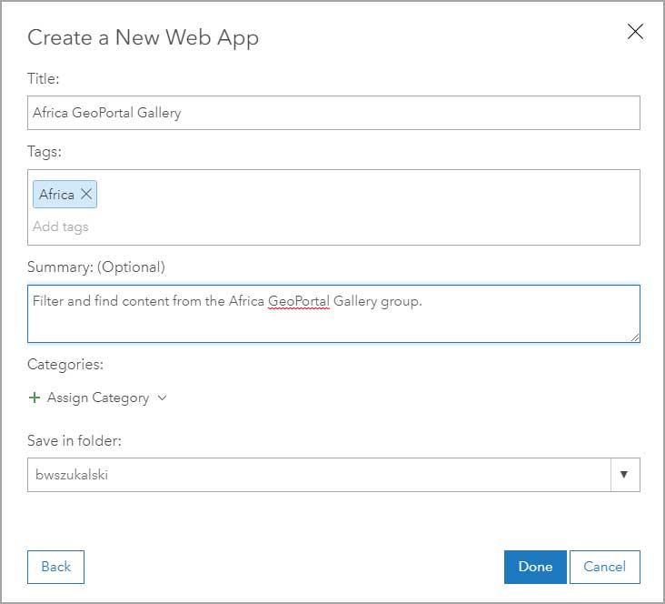

Step 9 — Enter a title for your app and tags (optional). Click Create app when finished.
Create app

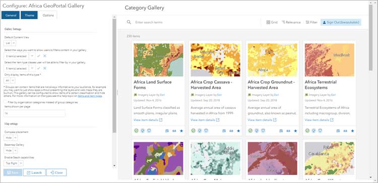

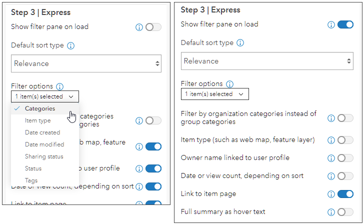

Step 10 — Configure the app. Express setup delivers the quickest way to change settings. The Gallery app example was configured using the default settings.
You can optionally change other settings as desired. For example, you may want to omit some filters, or have the filters appear when the app is opened, configure the content card, and so forth. When finished, click Publish.
