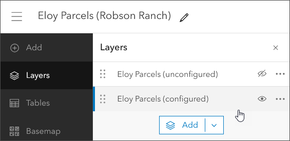

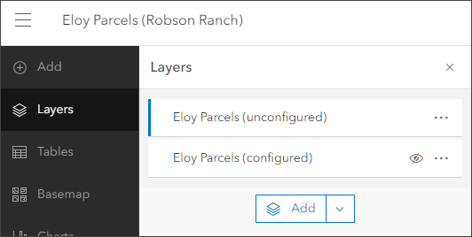

In this example, we’ll take a look at how to construct a URL string with parameters from attributes to pass information from a pop-up to another website. View the sample map to follow along (you can Sign In to save it). Open the Layers pane to view examples of both the unconfigured and configured layer pop-ups.

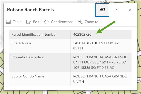

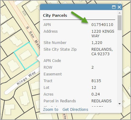

The unconfigured parcel layer pop-up is shown below. Note that the field Parcel Identification Number contains the unique identifier for each parcel.

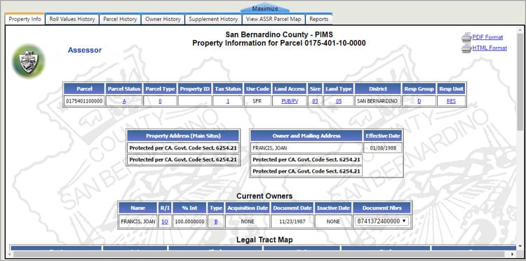

The Pinal County Assessor’s website delivers detailed information for every parcel. The information can be retrieved by searching on the owner name, address, or parcel identification number. Below we’ve retrieved the results for one of the parcels by entering the parcel identification number.
Taking a closer look at the URL, we found that the unique identifier (the parcel identification number) for each parcel is a parameter in the URL, appearing at the end after ?Parcel_ID=

Step 1 – Select the unconfigured layer in the Layer pane.

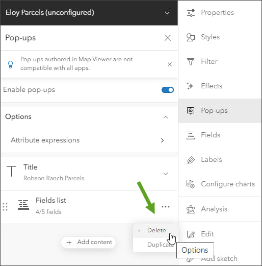

Step 2 – In the Settings (light) toolbar, click Pop-ups. Delete the Fields list since we will replace it with a text element.

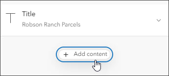

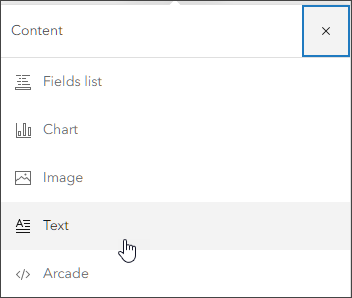

Step 3 – Click Add content.
Step 4 – Add a Text element.

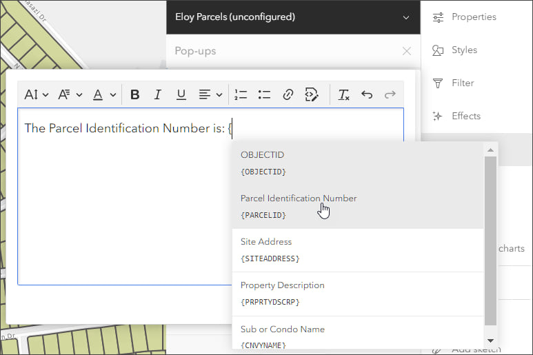

Using a text element you can use a combination of text, attributes, and links to create a custom information pop-up. Fields appear within curly braces { } and can be selected by typing the open brace { and then choosing a field from the drop-down list.
Add the desired text, type the open brace, and choose Parcel Identification Number.

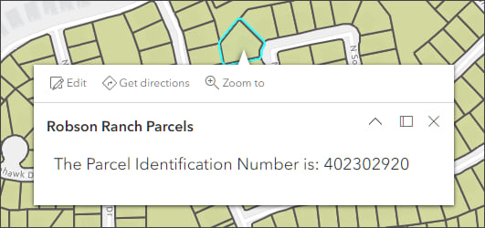

The pop-up now displays the parcel identification number in the parcel pop-up.

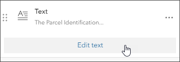

Step 6 – Click Edit text in the text element in the pop-up.

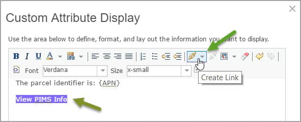

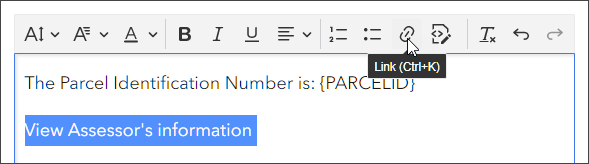

Step 7 – Add the text to be used for the link, in this case “View Assessor’s information.”
Step 8 – Select the text, then click the Link button.

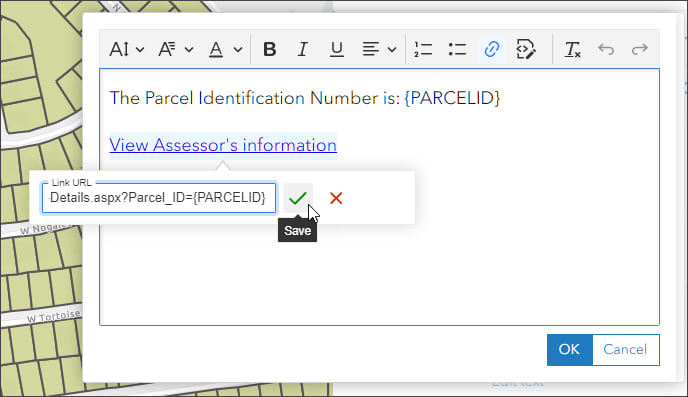

Step 9 – Construct the link with the parcel identification number as a URL parameter.
From examining the County Assessor’s site, we know that the link should look as follows:
https://app1.pinal.gov/Search/Parcel-Details.aspx?Parcel_ID=402301880
The link in our selected text will use the parcel identifier field as follows:
https://app1.pinal.gov/Search/Parcel-Details.aspx?Parcel_ID={PARCELID}
Add the link text as shown above, click the checkmark to save it, then click OK when finished.
Tip: You can add the field by typing it in manually, or an easier way is to copy the field name from the line above it and paste it into the link input.

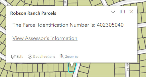

The pop-up now looks like this, with the View Assessor’s information hyperlink. The hyperlink opens the County Assessor’s page for the parcel when clicked. Mission accomplished!
