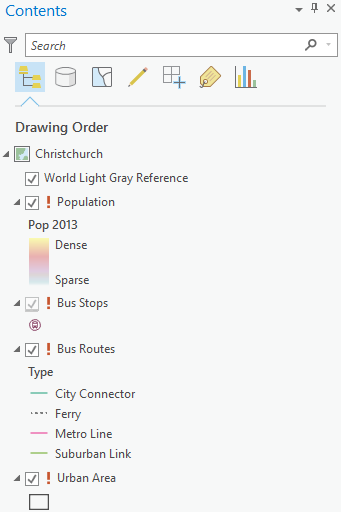

When you open a map or scene, ArcGIS Pro looks for the data referenced by each of the layers in the open map. When a data source cannot be found for a particular layer, that layer doesn’t draw. It only takes one glance at the Contents pane, and you’ll see those red exclamation points next to the layer that indicate a broken source.
Contents pane in ArcGIS Pro with broken links.
The red exclamation points next to each layer indicate that the link to the data source is broken.

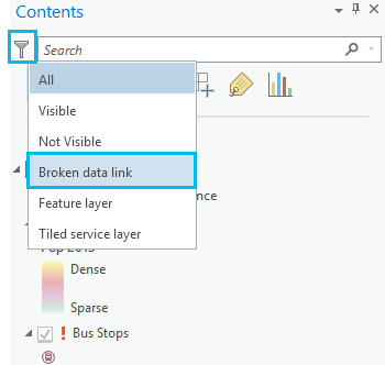

  1. You can quickly filter the Contents pane to show only the layers with broken data source links by clicking the Filter icon and click Broken data link.Click filter and click Broken data link.

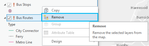

  2. If you don’t need to work with the layer, you can do nothing and continue to work with the map as-is, or remove it by right-clicking and clicking Remove.Right click to remove layer.

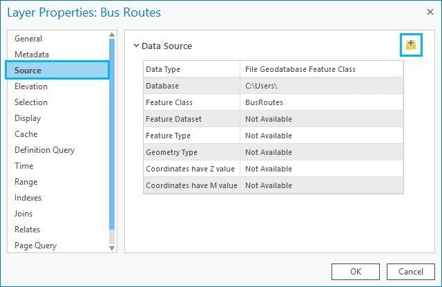

  4. If you only want to repair a link for one layer, you can change the data source property by right-clicking a layer and clicking Properties. On the Properties dialog box, click the Source tab and click Change data source to browse to the correct source. Click Change source to browse to the correct data source.

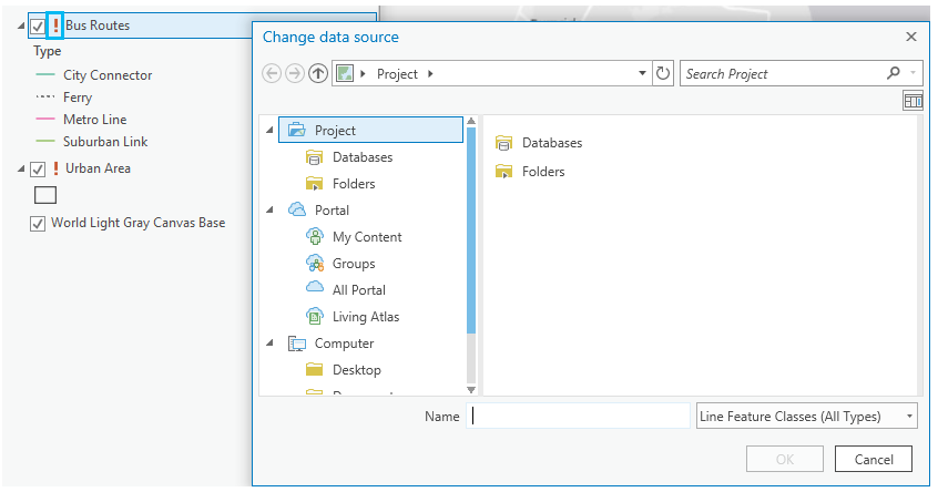

  5. If you have several layers that reference the same data source, that need to be fixed, you can repair the links one time in the Contents pane and ArcGIS Pro automatically repairs other broken layers. For example, if you have several feature classes stored in the same geodatabase, and the geodatabase has been renamed. Click the red exclamation point next to the layer to open the Change Data Source dialog box and browse to the correct source.
    Click the red exclamation point to change the data source. This will update the data source for all layers referencing the same broken source.

I am finding that it is very cumbersome to repair data sources for multiple layers. For example, if you change the location of your files in your directory (as happens when you migrate to One-Drive or change any folder names), then you need to fix data sources for all layers in all maps. In ArcMap, it was possible to right-click on one broken layer and select Data–>Repair Data Source, and it would automatically repair all layers with the same relative path (but different data sources). This does not seem to be possible in ArcPro. It is necessary to do each… Read more »
Benjamen Wetherill(@bwetherill69)
April 12, 2023 10:14 am
My question was answered in another forum. If you click on the red exclamation mark, it seems to do the same thing as ArcMap and repairs all related data sources.
