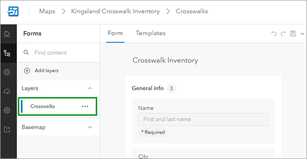

When you build a form in Field Maps Designer, you’re building a form for a specific layer. For example, the crosswalk inventory form shown below was built for a crosswalks layer:
Form built for a crosswalks layer

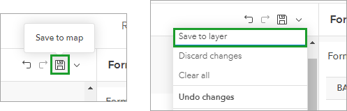

When you save the form, you can either save it to the map or to the layer. Saving to the map (using the Save button) saves the form to the specific map you’re working on and not to the layer. Save to the map when you don’t plan on reusing the form. To reuse the form across maps, save changes to the layer by clicking the drop-down menu next to the Save button and then clicking Save to layer.
Save to map and save to layer options
When the form is saved to the layer, it can be reused across other maps that contain the same layer. For this example, the crosswalk inventory form can be used in every city by adding the crosswalks layer (which now contains the form) to each corresponding map.
