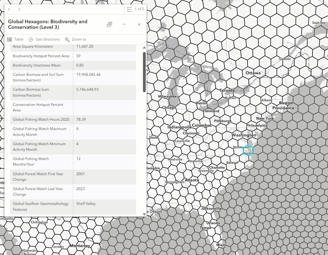

The newly released Global Hexagons for Biodiversity and Conservation layers provide a great foundation for illustrating how much pop-ups can enrich the experience of interacting with a map. These layers include over 50 attributes that summarize more than 20 different datasets, combining essential biodiversity and conservation data in one place.
screenshot of global hexagon field list

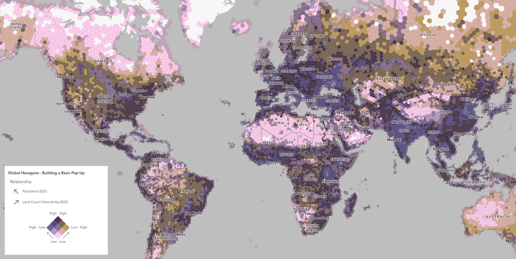

Let’s look at the relationship between population and projected land cover vulnerability in 2050. Symbology is a great way to translate numbers into a visual, but with an Arcade expression, we can add narrative context into what we’re seeing.
screenshot of global hexagons, relationship between population and vulnerable land cover
screenshot of arcade expression
The expression above uses a When() function to create conditional statements. If a selected hexagon meets the condition, it will return a descriptive statement instead of a number. This is a useful method to help translate numerical values into something more intuitive for the user. Combining the logic with some HTML, we can return a message in the pop-up that compliments the map’s symbology.

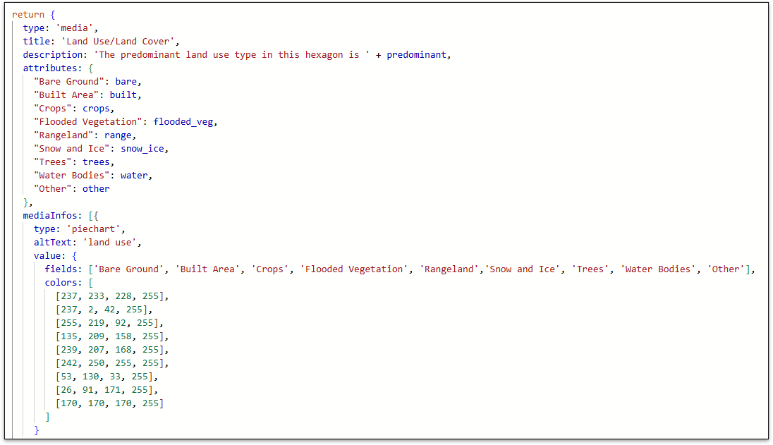

Dynamic Content – Adding a Chart
Another element we can pair with text in a pop-up is a chart. Charts offer an interactive way to tie together the rest of the pop-up content.
screenshot of arcade expression for charts
screenshot of arcade expression for chart element

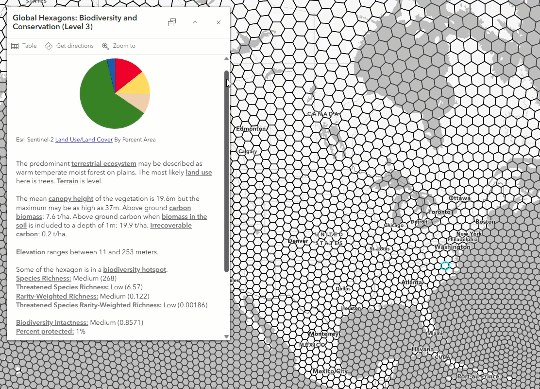

The examples above using the Global Hexagons layer show how Arcade can help transform raw data values and create a contextual pop-up that summarizes all the data inside the layer. Below is a preview of the foundational pop-up included with the Global Hexagon layers, add it to your own map and check out the Arcade!
screenshot of global hexagon layer with final popup
Explore the map to see these examples in action!

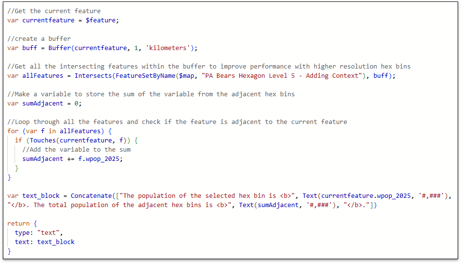

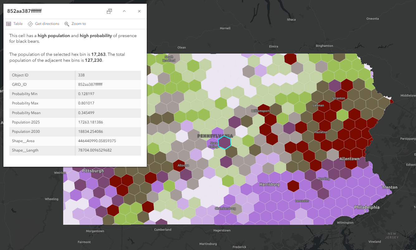

Getting More with Less
When working with layers that have fewer attributes, it can be harder to create informative pop-ups. In the next examples, we’ll use a hexagon layer that includes population data and the min/max/mean values for the probability of presence for black bears.
By using Arcade’s geometry functions, we can contextualize conditions for a selected hexagon to look at the relationship between population and maximum probability of black bear presence.
screenshot of layer popup

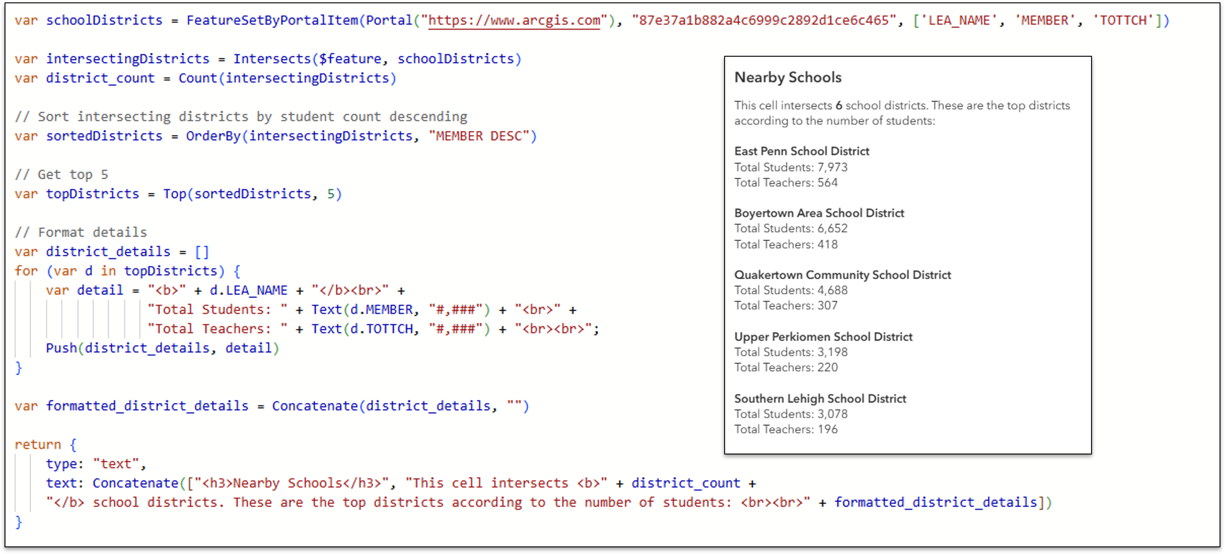

Another relevant dataset might be School District Characteristics, which includes attributes like number of schools, students, and teachers.
screenshot of arcade expression and school details

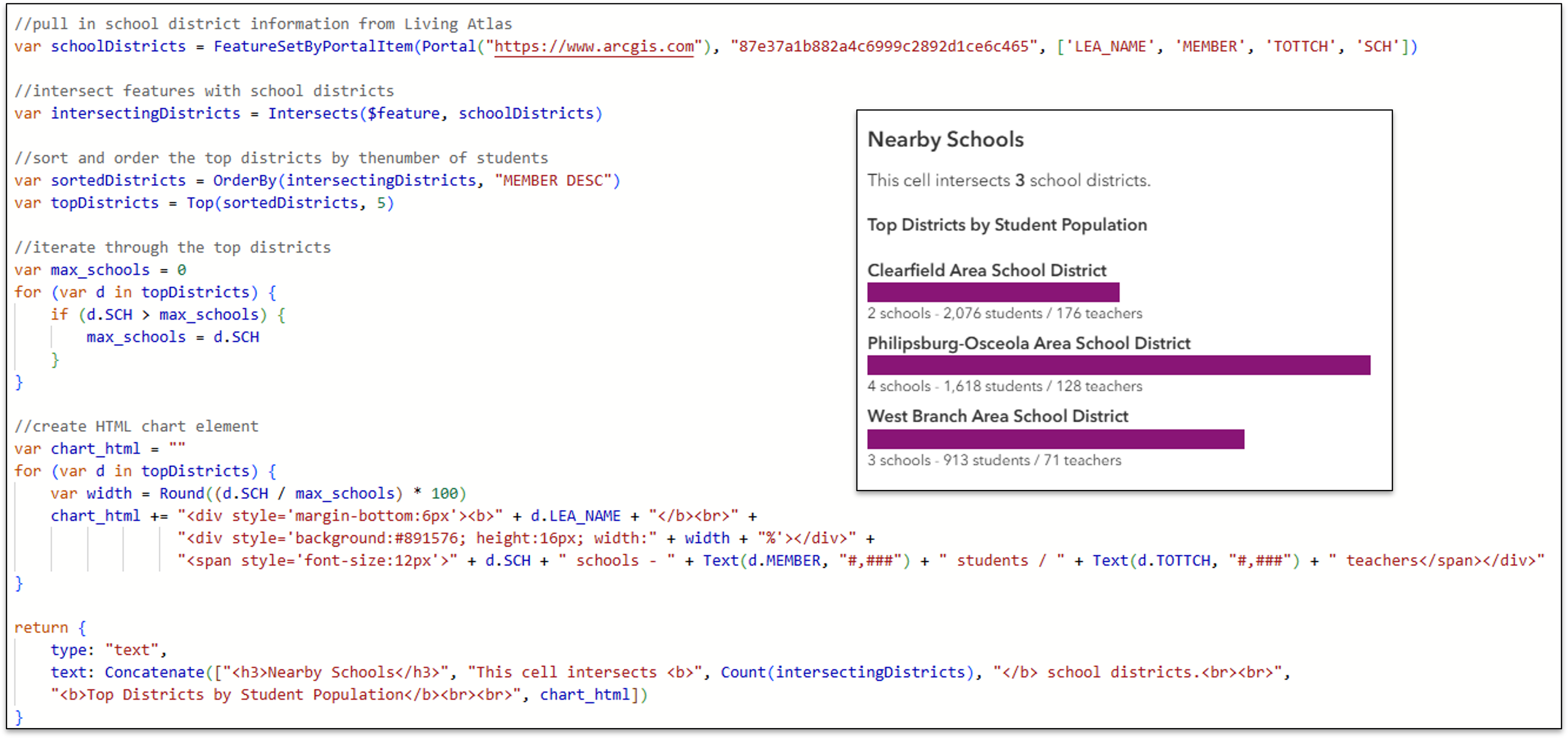

More Than One Way to Visualize
There is often more than one way to accomplish something in Arcade. Whether you’re formatting data, building logic, or adding visuals, Arcade gives you the flexibility to be creative.
For example, instead of using the Media element to define a chart, you can also use HTML to build a more static bar chart.
Check out this map for the examples pulling in content from the Living Atlas.
screenshot of arcade expression with school details chart
