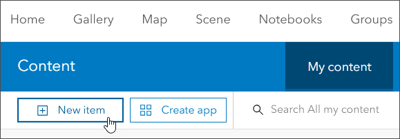

Step 2 — In My Content, click New Item.
New item

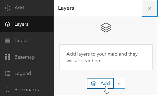

Or add the layer to any map via Add:
Add layer
