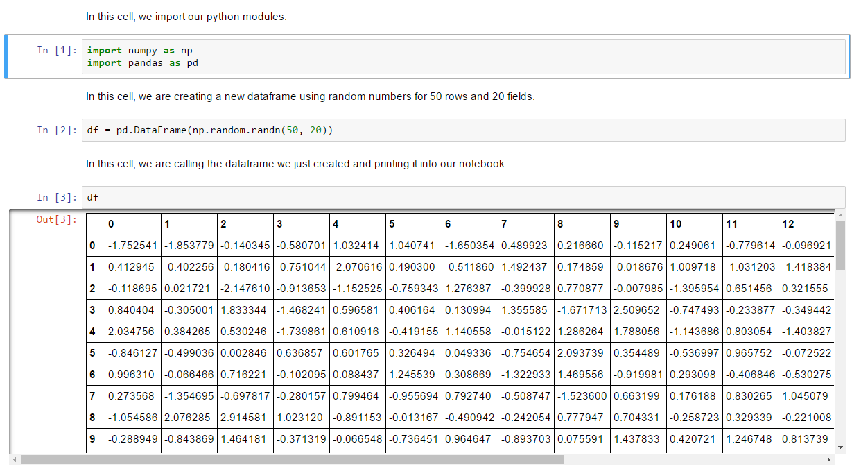

2. Visualizing Pandas Dataframes
Pandas (Python Data Analysis Library) provides high-performing and easy-to-use data structures that allow you to work with large amounts of data extremely fast. The core data object is a Dataframe, which is essentially an in-memory table that allows powerful indexing operations.
Jupyter Notebook allows you to visualize these tables at any point in your notebook. This is extremely useful because you can view the state of your data (and the effect of all the actions your code is performing on your data) as each step of your logic executes. This capability reinforces the use of Jupyter Notebook in a prototyping workflow when you are attempting to confirm that your workflow is doing what it needs to do at each step of the way.
Showing a Dataframe in a code cell can go a long way to understanding how your code operates.
So why are Pandas Dataframes such a big deal?
As a GIS user, the first foray into working with Python and GIS data management typically uses some mix of arcpy’s “CalculateField”, “SearchCursors”, and “UpdateCursors”. Most of the examples teach you to use these operations and they are all completely functional, but they suffer from the same process-intensive issue: they all need to iterate upon every record of your data to perform a data management operation.
In other words: Imagine that you are a director of a movie in production, and you find out that to change the lighting in a scene, you need to watch the movie from the very beginning… for every change. This would take forever!
Operating on a Pandas Dataframe solves for this with powerful indexing that allows effective querying and array-wide operations. You essentially find the specific scene of the movie that you need to fix, and skip to that scene. Once my GIS data analysis workflows started integrating Pandas Dataframes into heavy data operations, I saw exponential improvements in performance.
Visualizing these Dataframes and seeing the effects of my code in each dataset became a crucial component of working efficiently.
