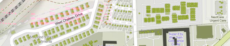

Earlier this year, Esri assembled some open data shared by ArcGIS users and then added this data into OpenStreetMap (using the ArcGIS Editor for OSM) following their import guidelines. This was done for building footprints and address points in the cities of Redlands, California and Flagstaff, Arizona (two of my favorite places). With the support of these cities, and a couple weeks of effort, we were able to add over 100,000 useful features that did not previously exist in OSM! This data soon became available to ArcGIS users through the OSM Feature Layers and the OSM Vector Basemap described above, and is now also available for other use cases such as geocoding.
OSM Buildings and Address Points displayed on OSM Basemap in Flagstaff, Arizona.

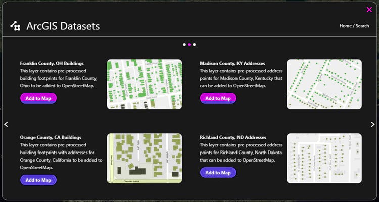

In this updated version of RapiD, there is now an option to View/Manage Datasets, which features a collection of open ArcGIS Datasets that are also available to use for editing. Esri has assembled this data from the ArcGIS user community, verified that it is compatible with the OSM Open Database License, processed the data for integration with OSM, published the data to ArcGIS Online as feature layers, and curated the layers into this group to be accessed by RapiD and JOSM, or other OSM editor apps (pause to catch breath).  You can see a complete list of the available ArcGIS Datasets on the OSM Wiki, including data that is available to edit and data that is available to review.
The main benefits of the ArcGIS Datasets relative to the AI generated datasets in RapiD and JOSM are that most of the features have already been hand-edited by GIS pros and include more fields (e.g. name, address, height, etc.) that are populated with useful data from the local data provider (e.g. city or county). In addition, Esri has done some extra data processing to normalize the fields from the various local data providers to the expected fields of the local OSM community (e.g. convert ‘Street’ = ‘W Main St’ to ‘addr:street’ = ‘West Main Street’).
Using RapiD, you can select one of the ArcGIS Datasets (e.g. Orange County, CA Buildings, such as above), center map on that dataset, and zoom in to an area where you would like to make edits. RapiD will only display the features that do not conflict with existing features in OSM so that you don’t accidentally duplicate or replace those features.

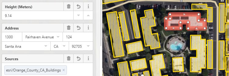

When you select a feature and click “Use this Feature” in the feature editor, a set of fields will be populated from the feature in the ArcGIS dataset, which may vary by dataset and feature. You can review and edit the values of these fields (such as below) or add values for more fields. You can then repeat the process for more features. When you are done with the edits you’d like to make, you can save your edits and upload your changes to OSM. RapiD will add a few tags for your changes, including the data source used.
