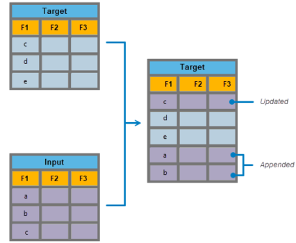

The Append tool provides a way to add (and optionally update) data to an existing dataset. Think of it like copying and pasting rows from one table into another, but smarter. When you add new rows, you can either add everything (even duplicates) or update existing records based on a matching ID field.
Use the Append tool to add and update attributes in a Target dataset
Append tool illustration
The Append tool is great for keeping a dataset fresh without having to rebuild it from scratch each time you receive new or updated data. And it works with feature services, so you can push any changes directly to feature layers in your organization’s portal.

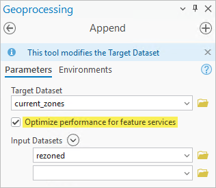

When managing feature services, particularly those with large or frequently changing layers, the faster the update, the better. So, in ArcGIS Pro 3.5, the Append tool has a new Optimize performance for feature services parameter to speed up processing.
Note: In Pro 3.5, only the data owner or administrators can enable optimization.
The Append tool’s new Optimize performance for feature services parameter
This new parameter is enabled when the Target Dataset is a web layer and the supportsAppend metadata property is True. Appending data in an Enterprise feature service also requires that editing is enabled with Add, Delete, or Update (which enables the uploads capability).
Note: View a layers supported properties in its ArcGIS REST Services Directory page.

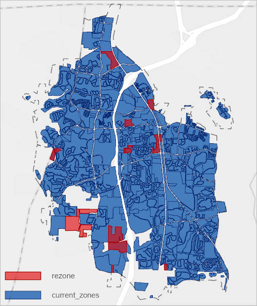

Data: You started your first GIS internship at the Town of Cary, NC. For your first assignment, you must update zoning data within zip code 27519. You receive access to 2 feature layers in your organization’s portal: current_zones and rezoned areas.
Current_zones and rezone
Current_zones and rezone web layers
In the map above, notice that some zones are new and others overlap existing areas, so you’ll need to insert and update features in the current_zones feature layer.
To update existing zones, match features based on an ID field with matching values.

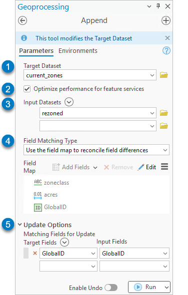

Open the Append tool and set the following parameters:
Append tool
Append tool with steps
1.  Target Dataset: current_zones
2.  Optimize performance for feature services will automatically enable.
3.  Input Datasets: proposed_rezone
4.  Field Matching Type: Use the field map to reconcile field differences
Selecting this option will activate the field map, which you can use to match the fields:
zoneclass ; ProposedZone
acres ;  acres
GlobalId ; GlobalId
Learn more about how to use the field map for field matching
5.  Matching Fields for Update: GlobalId ; GlobalId
Run the tool

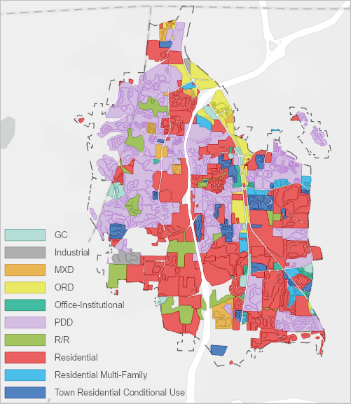

Result: The existing zones will update with a new zone class, and the new rezoned areas will be added to the feature layer!
Updated Zones
Updated Zones
