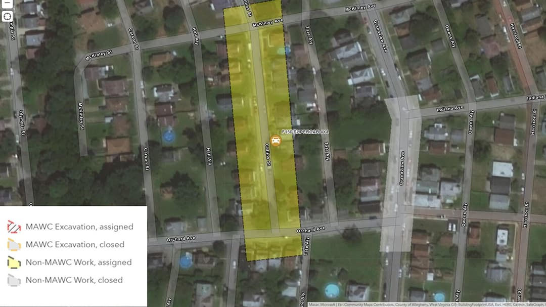

Before incorporating the real-time excavation notices and their associated dig boxes into the GIS, the location of excavations was only known to staff responsible for visiting those sites and marking MAWC's assets. These six employees, who are referred to as locators, would then manually compare the locations of these excavations with our GIS to determine if any assets needed to be marked. With GeoEvent Server, those dig boxes now appear directly on our web map along with our GIS features, allowing a locator—or their fill-in—to quickly understand where excavations would take place and what assets would need to be marked.
In addition to meeting our goal, having dig boxes on the map resulted in an unintended benefit—now other staff are aware of where excavations are taking place. Whether it is a customer communication representative on the phone with a customer who is wondering why someone just spray-painted a blue mark in their front yard or management now being able to see where our crews are digging, this real-time data is being used to answer questions from staff not directly related to locating.

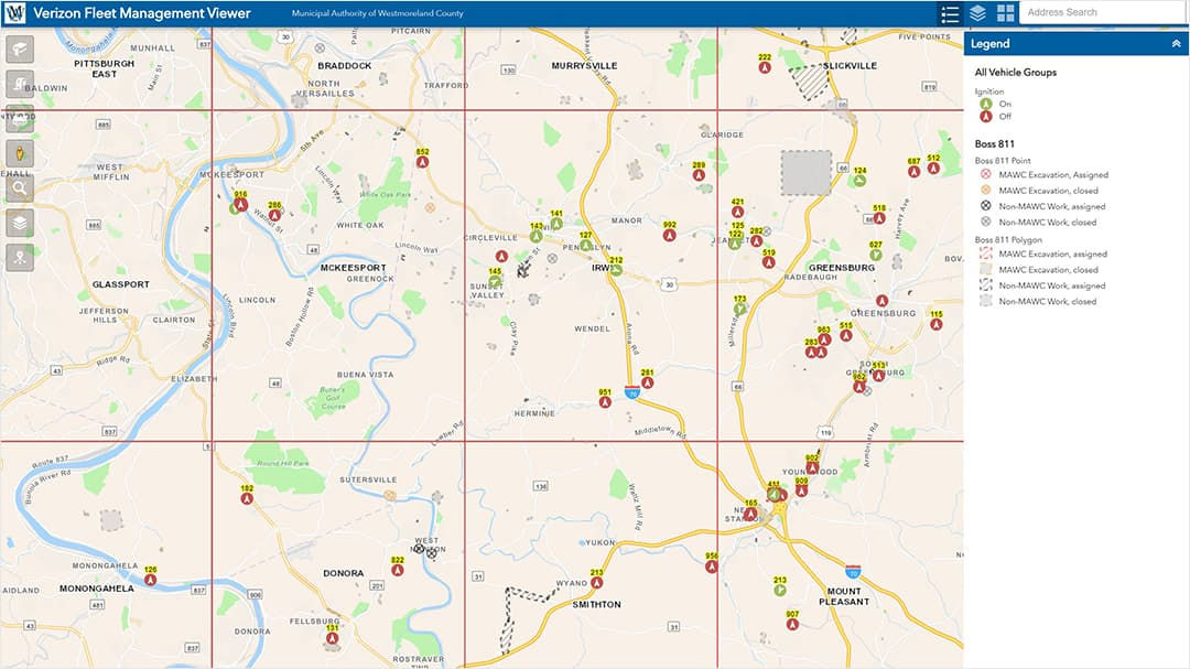

The value of our GIS was further enhanced with real-time vehicle location. Incorporating vehicle locations into GeoEvent Server was done via an API with Verizon Network Fleet. Several times a minute, monitored vehicles check in with Verizon, information MAWC sends directly to GeoEvent Server and then onto maps for staff to consume. Quickly, we were able to find that a few of the units in vehicles needed to be replaced, as they were not returning data.
With locations of work and the work vehicles now on the map, we can see in real time as staff complete their tasks. The data has led to geoenabling, as we have empowered management to also find answers using robust maps and dashboards. One example of this is a foreman on nightshift using the Fleet Management Viewer application to view real-time vehicle locations and find where the closest excavator has been parked. Empowerment like this saves time and money while also replacing the late-night phone calls that would have taken place to find the same equipment.
