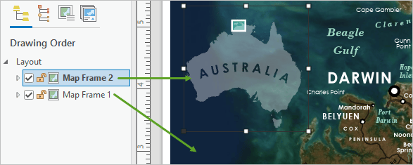

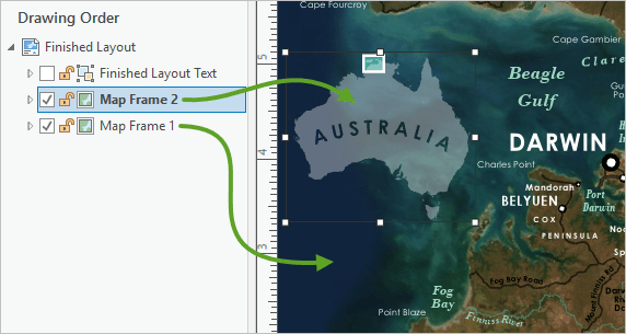

This layout has two maps in it: Map Frame 1 is the main map of the Darwin region. Map Frame 2 is the key map of Australia, sitting transparently on top.
Map Frame 1 contains the main map while Map Frame 2 contains the locator map

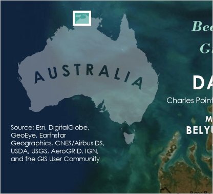

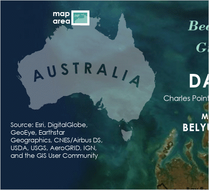

I do want to add some text to the key map. I’m worried that it’s not clear that the little box sitting on top of Australia represents the map area.

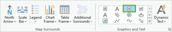

On the ribbon, click the Insert tab. This is where you’ll find anything that you want to add to a layout, from photos to graticules. In the Graphics and Text group, click the Rectangle Text button.
Rectangle text button on the ribbon

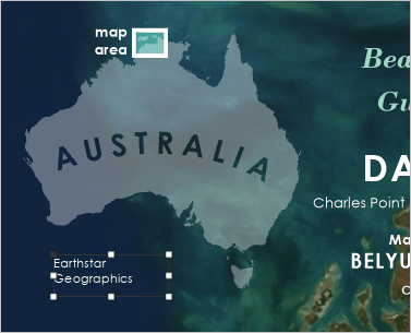

Drag a rectangle on the layout near the keymap locator box.
Text box next to locator map with text highlighted for editing

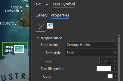

Type map area.
If necessary, double-click the Text element in the Contents pane to open the Element pane. Here you can adjust the Text Symbol properties to match the rest of the map.
Properties for map area text are set to Century Gothic Bold 7pt white
If you now drag either of the maps around, you’ll find that the map area text stays in place on the page, while all the other text moves with the map.
Moving the locator map over the main map
That’s what makes layout text different from labels and annotation. It belongs to the layout, not the map.

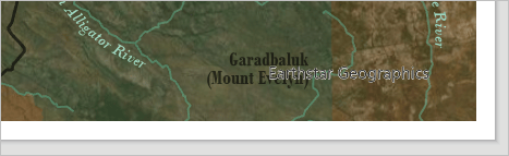

There is some other text on the layout already. It’s the credits for the imagery basemap.
Service layer credits at the bottom of the map
And they are not very easy to read against your busy background. But don’t worry, you can convert this text into something nice that matches the formatting of the rest of the map.

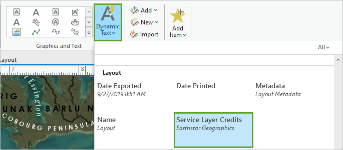

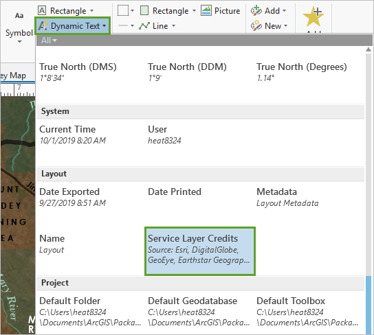

On the ribbon, click the Insert tab and click Dynamic Text. Scroll down in the menu and choose Service Layer Credits.
Service Layer Credits option in the Dynamic Text gallery

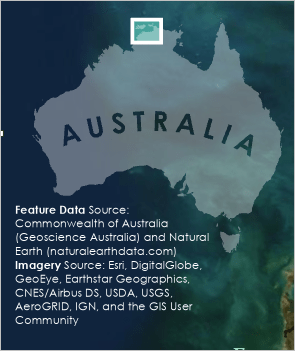

Draw a rectangle somewhere on the map where you’d like the credits to go, and watch the text disappear from the bottom of your map and reappear in your chosen spot. You can’t change what it says, but you can edit how it appears.

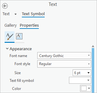

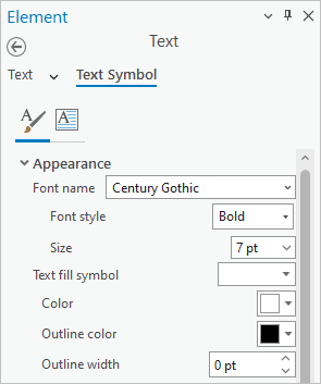

In the Element pane, click the Text Symbol tab and the General tab to update font properties.
Text Symbol properties set to Century Gothic Regular 6pt white
Much better, no?
Source credit text in white next to the locator map

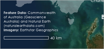

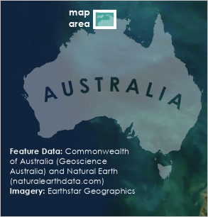

Your map may have different sources as the basemap is updated. But there are more data sources that you need to cite than just the basemap.

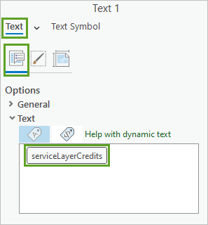

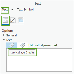

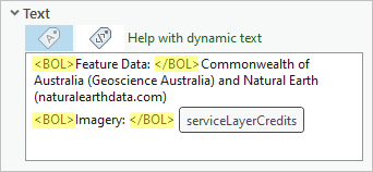

In the Element pane, click the Text tab and click the Options tab. Inside the text editing box there is a tag for the existing dynamic text.
Service layer credits shown as a tag in the Text box
Place your cursor in front of the dynamic text and paste
Feature Data: Commonwealth of Australia (Geoscience Australia) and Natural Earth (naturalearthdata.com)
Imagery:
You can also add stuff like Cartography: Your Name, Date if you like.
And you can add text formatting tags to make this block of text easier to read. I used <BOL></BOL> to bold some words.
Tags surrounding some text
Final formatted credits text on the map

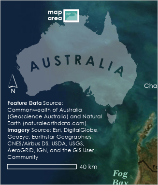

Next, you can add a scale bar.

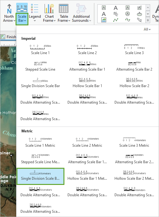

On the Insert tab of the ribbon, click the bottom part of the Scale Bar button. Choose Single Division Scale Bar from the Metric list.
Single Division Scale Bar in the Metric scale bar gallery
Drag a rectangle on the layout to add your new scale bar.

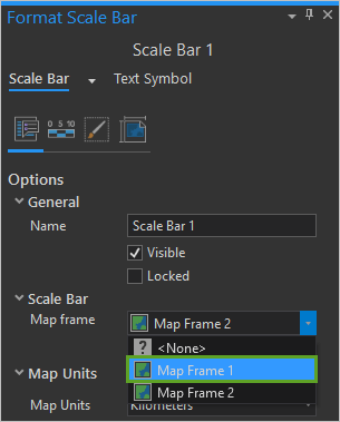

Default scale bar on the map with black text
Tip: If your scale bar says something like 2,000 kilometers, it’s referring to the key map instead of the main map. You can fix this problem in the Element pane by changing the Map frame to Map Frame 1.
Map Frame 1 in the Scale Bar Map frame menu

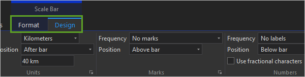

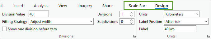

On the ribbon, experiment with the options on the Scale Bar and Design tabs to customize the scale bar until it looks just the way you like.
Ribbon tabs for scale bars

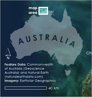

You can refer to the settings I used in the Finished Layout if you want it to look like this:
Finished scale bar in white
You can add a north arrow in the same way.
Completed locator map and surrounding text

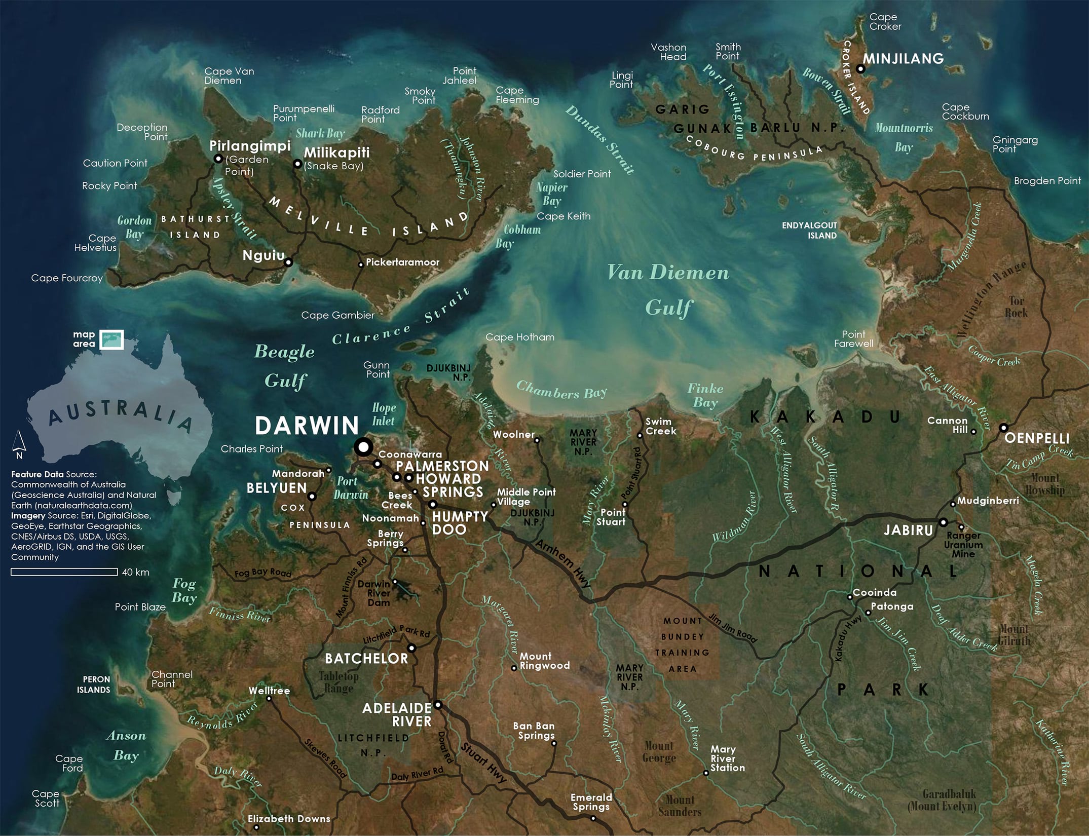

And there it is! A finished map—with label classes converted into annotation, enhanced with masks, and topped off with a bit of graphic layout text.
Completed map of Darwin, Australia
