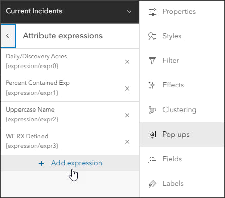

Attribute expression
If the layer already has attribute expressions they will be listed. Click to open any existing attribute expression or click Add expression to begin a new one.
Attribute expressions

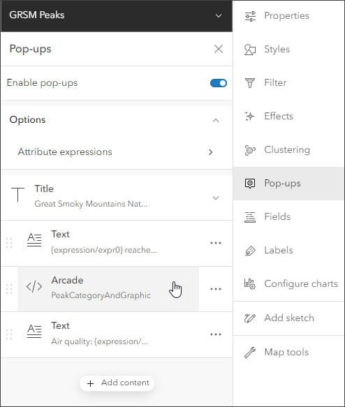

To view the content blocks, open the layers pane from the Contents (dark) toolbar and select the layer you want. On the Settings (light) toolbar, click Pop-ups, then view the list of content blocks. Arcade elements are listed using the code symbol – </> – and titled Arcade.
Arcade element
To add a new Arcade content block, click Add content and choose Arcade.
Arcade element

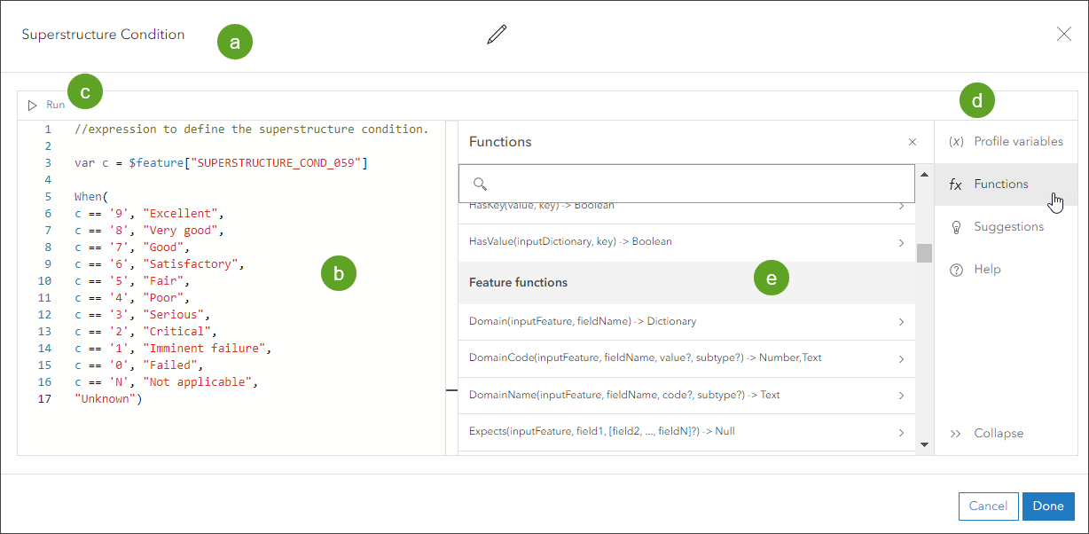

The Arcade editor is used to create new attribute expressions and Arcade content blocks, or edit existing ones. It includes the following:
a – Name
b – Expression
c – Run (test) button
d – Action bar with options to display profile variables, functions, suggestions, and help
e – Action pane, with more information about the selected action.
Arcade editor
View larger image
Profile variables are special global variables that can be used in expressions. For example, $feature references the feature you click on your map to open the pop-up. This variable is used to retrieve specific attributes (fields) for the feature. For example, $feature.name returns the content of the field “name” for the feature.
Functions are used to calculate values in expressions. Functions are grouped and categorized into constants, data functions, feature functions, math functions, text functions, and so on. For example, Round is a math function that rounds the input numerical value to the specified number of places, and returns the new rounded number. Each function has built-in help so you can learn how to use them. You can also create your own custom functions for use in expressions.
Suggestions provide a list of existing expressions so that you can copy some or all of an expression into a new one.
Help links to the Arcade help documentation.
The Arcade editor also includes Intellisense, helping to reduce errors and helping to complete the expression as you write it. Warnings also appear in the editor, helping you understand when there’s something in your expression that could be a problem or could be improved.
Intellisense and error checking
View larger image

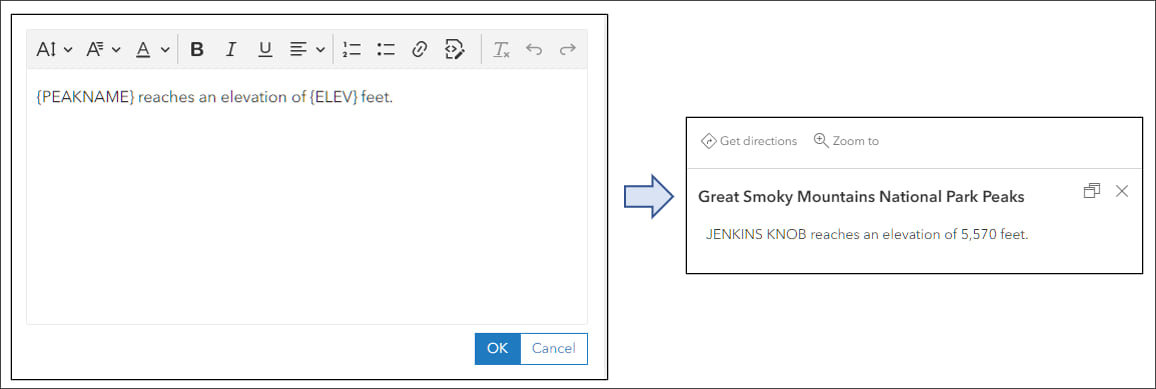

The text element shown below uses the {PEAKNAME} and {ELEV} fields to create the pop-up.
Pop-up
View larger image

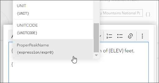

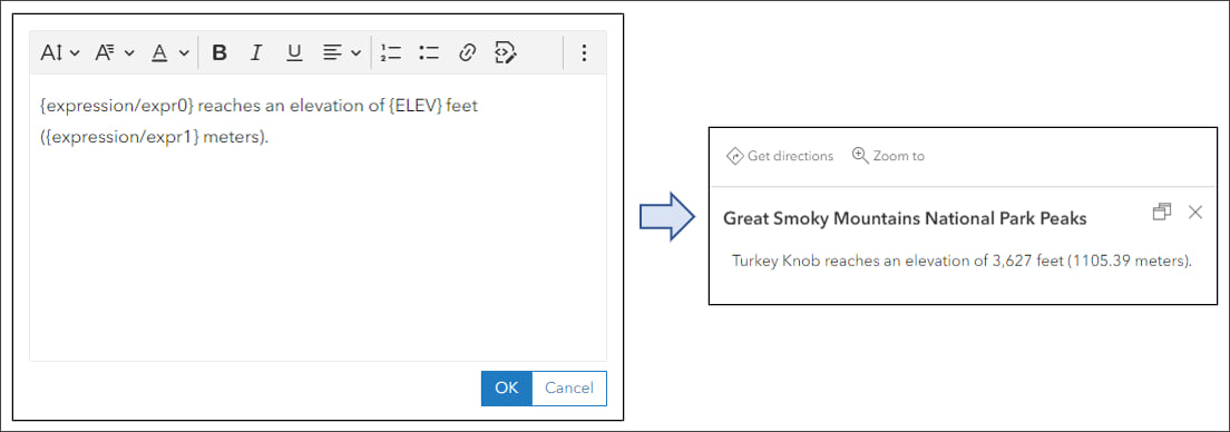

Step 6 — Use the expression in the text element just like any other field. Enter the curly brace { in the text element to display a list, the expressions are found at the bottom.
Select expression
The text elements now returns the proper case peak name.
Text element with expression

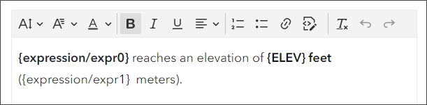

This expression can be used in the text element as shown below.
Arcade expression
View larger image

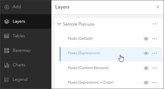

You can follow along by viewing the sample map and opening the Sample Pop-ups layer group, then selecting and viewing the Peaks (Element) layer. In this example the Arcade content element is similar to the pop-up created with attribute expressions above, with some additional HTML styling. Compare Peaks (Expressions) and Peaks (Content Element) to understand the two approaches.
One of the biggest differences between Arcade attribute expressions and Arcade content elements is that attribute expressions are used in text elements, and Arcade content elements are intended to return a complete part of your pop-up, either independently or combined with other elements. While the Arcade behind both expressions and elements is very similar, Arcade content elements are self-contained, so anything you need must be done within the element.
When you open the Arcade editor, there are several templates that help you get started. By default, the Rich text template is opened.
